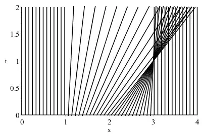

Let us complete the answer by @RRL.
a) The breaking time is $$t_b = \frac{-1}{\inf f'} = 1$$
b-c) This is illustrated on a sketch of the characteristic curves in the $x$-$t$ plane:
characteristics
On both sides of the shock, the solution at $t>1$ is deduced from the method of characteristics $u = f(x-ut)$. Hence, $u$ is equal to $\frac{x-1}{1+t}$ or zero on each side of the shock. To compute, the shock trajectory $x_s(t)$ with the shock velocity $\dot x_s(t)$, we apply the Rankine-Hugoniot condition $$ \dot{x}_s(t) = \frac{1}{2} \left(\frac{x_s(t)-1}{1+t} + 0\right) ,\qquad x_s(1) = 3 , $$ which gives $x_s(t) = 1 + \sqrt{2 (1+t)}$ and $\dot x_s(t) = \sqrt{2(1+t)}^{-1}$. At $t> 1$, the solution is $$u(x,t) = \left\lbrace \begin{aligned} &0 &&\text{if}\quad x<1 \quad\text{or}\quad x > 1 + \sqrt{2 (1+t)} \\ &\frac{x-1}{1+t} &&\text{if}\quad 1\leq x < 1 + \sqrt{2 (1+t)} \end{aligned} \right. $$
