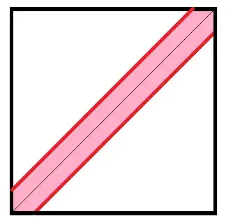

Your calculation should be $$1- \displaystyle 2\int_5^{60}\int_0^{y-5}\left(\frac{1}{60}\right)^2\,dx\,dy$$ which would be $1-\frac{55^2}{60^2} \approx 0.1597$ or slightly less than $\frac16$. I am not sure you have multiplied by $2$ or subtracted from $1$. Perhaps this picture helps

  • @ Henry why not to solve it using just simple geometry where the searched probability is the difference between the surface of the whole square - 2 * the surface of the white lower triangle $1-2 \frac{1}{2} (\frac{11}{12})^2=\frac{23}{144} \approx \frac{1}{6}$. Isn't the double integral over complicating the solution? – Michal Dec 10 '16 at 23:11
