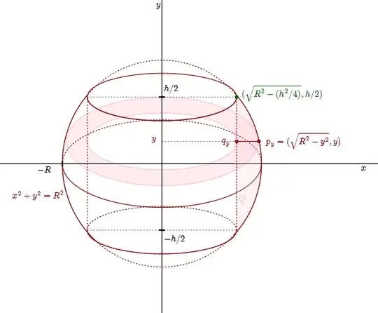

The "napkin ring" is generated by revolving the light pink region $\color{pink}{Q}$, shown below, about the $y$-axis. This volume can be found using the washer method. A typical washer, generated by revolving the line segment $\overline{\color{maroon}{p_yq_y}}$ about the $y$-axis, is shown below. The coordinates of the endpoints of the line segment can be found using the Pythagorean Theorem and the fact that the sphere has radius $R$ and the cylinder has height $h$ (so the top of the cylinder crosses the $y$ axis at $y=h/2$).
The volume is $$ \int_{-h/2}^{h/2} \pi\Bigl[ \, \Bigl(\underbrace{\sqrt{R^2-y^2}}_{\text{outer radius}\atop \text{of the washer} }\ \Bigr)^2-\Bigl(\underbrace{\sqrt{R^2-(h^2/4)}}_{\text{inner radius}\atop \text{of the washer} } \ \ \Bigr)^2\, \Bigr ] \, dy= \int_{-h/2}^{h/2} \pi\bigl(\, {\textstyle{h^2\over 4}}-y^2 \,\bigr) \, dy. $$
Note that, as André Nicolas points out, the volume is independent of $R$.
Calculating the integral above, and taking advantage of symmetry, the volume of the solid is: $$ \eqalign{ \int_{-h/2}^{h/2} \pi\bigl(\, {\textstyle{h^2\over 4}}-y^2 \,\bigr) \, dy &=2\int_{0}^{h/2} \pi\bigl(\, {\textstyle{h^2\over 4}}-y^2 \,\bigr) \, dy\cr &=2\pi\bigl[ {\textstyle{h^2\over 4}}y-{\textstyle{y^3\over 3} } \bigr]\bigr|_0^{h/2}\cr &= 2\pi\bigl[ {\textstyle{h^3\over 8 }}-{\textstyle{h^3\over 24} } \bigr]\cr &={\pi h^3\over 6}.
(It's probably best to read André's more detailed answer and just refer to the diagram if need be. The labeling and orientation of the diagram, though, is different from André's answer (in particular the $x$ and $y$ axes are interchanged). His region $\cal W$ is the region $\color{pink}{Q}$ above. )
