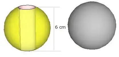

Given a solid sphere of radius R, remove a cylinder whose central axis goes through the center of the sphere.
In a solid sphere I did a diametral hole with a cylindrical drill. I know that the distance between the two border holes formed is 6cm. How can I calculate the remainder volume in the sphere?
