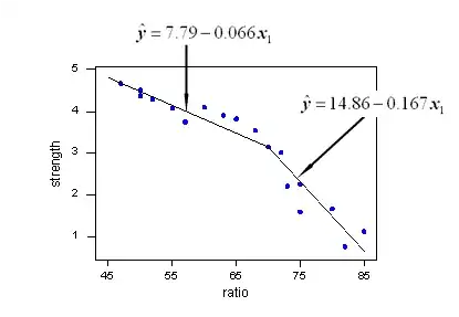

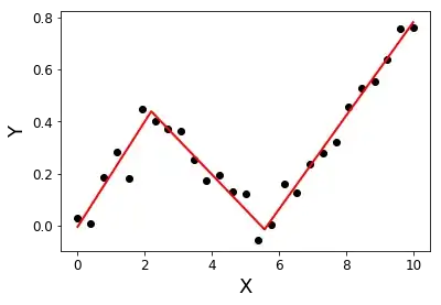

I am looking for a Python library that can perform segmented regression (a.k.a. piecewise regression).
Example:

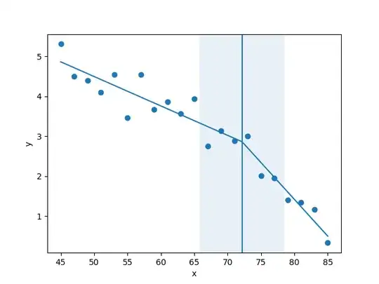

The piecewise-regression Python library does exactly this.
import piecewise_regression
x = [45, 47, 49, 51, 53, 55, 57, 59, 61, 63, 65, 67, 69, 71, 73, 75, 77, 79, 81, 83, 85] y = [5.31, 4.5, 4.4, 4.1, 4.55, 3.47, 4.55, 3.67, 3.86, 3.56, 3.94, 2.75, 3.14, 2.89, 3.01, 2.01, 1.95, 1.4, 1.35, 1.17, 0.33]
pw_fit = piecewise_regression.Fit(x, y, n_breakpoints=1) pw_fit.plot()
plt.show()
piecewise-regression example

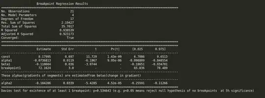

And it gives you a statistical summary:
pw_fit.summary()
peicewise-regression summary
It uses the same method as the segmented R package.

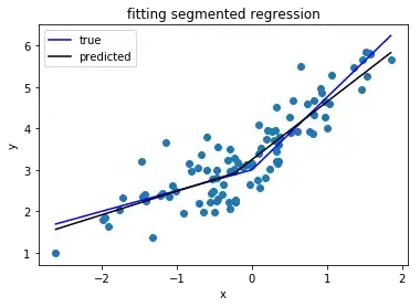

This code will return a vector of estimated coefficients to you:
[ 0.57   0.     0.     0.     0.     0.825  0.     0.     0.     0.     0.   ]
Due to Lasso approach, it is sparse: the model found exactly one breakpoint among 10 possible. Numbers 0.57 and 0.825 correspond to 0.5 and 1.25 in the true DGP. Although they are not very close, the fitted curves are:
This approach does not allow you to estimate the breakpoint exactly. But if your dataset is large enough, you can play with different k (maybe tune it by cross-validation) and estimate the breakpoint precisely enough.
