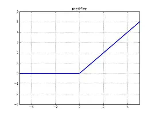

Let's review how the ReLU (Rectified Linear Unit) looks like :
The input to the rectifier for some input $x_n$ is $$z_n=\sum_{i=0}^k w_i a^n_i$$ for weights $w_i$, and activations from the previous layer $a^n_i$ for that particular input $x_n$. The rectifier neuron function is $ReLU = max(0,z_n)$

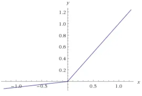

As @Neil Slater mentioned, a fix is to modify the flat side to have a small gradient, so that it becomes $ReLU=max(0.1x,x)$ as below, which is called LeakyReLU. enter image description here

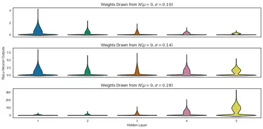

In general, what happens depends on how information flows through the network. You can imagine that as training goes on, the values neurons produce can drift around and make it possible for the weights to kill all data flow through some of them. (Sometimes, they may leave these unfavorable configurations due to weight updates earlier in the network, though!). I explored this idea in a blog post about weight initialization -- which can also contribute to this problem -- and its relation to data flow. I think my point here can be illustrated by a plot from that article:
Activations in a ReLU MLP with different initialization strategies
The plot displays activations in a 5 layer Multi-Layer Perceptron with ReLU activations after one pass through the network with different initialization strategies. You can see that depending on the weight configuration, the outputs of your network can be choked off.
