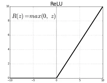

Activation functions are used to introduce non-linearities in the linear output of the type w * x + b in a neural network.
Which I am able to understand intuitively for the activation functions like sigmoid.
I understand the advantages of ReLU, which is avoiding dead neurons during backpropagation. However, I am not able to understand why is ReLU used as an activation function if its output is linear?
Doesn't the whole point of being the activation function get defeated if it won't introduce non-linearity?

In mathematics (linear algebra) a function is considered linear whenever a function$f: A \rightarrow B$ if for every $x$ and $y$ in the domain $A$ has the following property: $f(x) + f(y) = f(x+y)$. By definition the ReLU is $max(0,x)$. Therefore, if we split the domain from $(-\infty, 0]$ or $[0, \infty)$ then the function is linear. However, it's easy to see that $f(-1) + f(1) \neq f(0)$. Hence by definition ReLU is not linear.
Nevertheless, ReLU is so close to linear that this often confuses people and wonder how can it be used as a universal approximator. In my experience, the best way to think about them is like Riemann sums. You can approximate any continuous functions with lots of little rectangles. ReLU activations can produced lots of little rectangles. In fact, in practice, ReLU can make rather complicated shapes and approximate many complicated domains.

Definitely it is not linear. As a simple definition, linear function is a function which has same derivative for the inputs in its domain.
The linear function is popular in economics. It is attractive because it is simple and easy to handle mathematically. It has many important applications. Linear functions are those whose graph is a straight line. A linear function has the following property:
$f(ax + by) = af(x) + bf(y)$
ReLU is not linear. The simple answer is that ReLU's output is not a straight line, it bends at the x-axis. The more interesting point is what’s the consequence of this non-linearity. In simple terms, linear functions allow you to dissect the feature plane using a straight line. But with the non-linearity of ReLUs, you can build arbitrary shaped curves on the feature plane.

The main reason to use an Activation Function in NN is to introduce Non-Linearity. And ReLU does a great job in introducing the same.
Three reasons I choose ReLU as an Activation Function
  • First it's Non-Linear( although it's acts like a linear function for x > 0)
  • ReLU is cheap to compute. Since it's simple math, model takes less time to run
  • ReLU induces sparsity by setting a min value of 0
