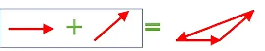

Hope this figure below illustrates how ReLU becomes useful.
With the ReLU activation and a proper adjustment of weights, the 2nd layer can probably compute a new feature (a triangle). If we add a 3rd layer, the third corresponding neuron can probably compute a feature that looks like a quadrilateral, and so on... (This can even be imagined like playing a game of building blocks with a child!)
This property of ReLU that it helps each layer to act as building blocks for the next layer, makes it extremely powerful (regardless of the dataset we train on). Also, ReLU is computationally much more efficient and simple than any other activation function (it's either a 0 or the same thing, $z$). Hence ReLU becomes the best choice for most types of data (unless the data inherently has some properties that can be better modelled by other activation functions like the sigmoid or tanh).
