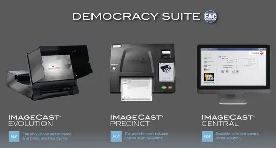

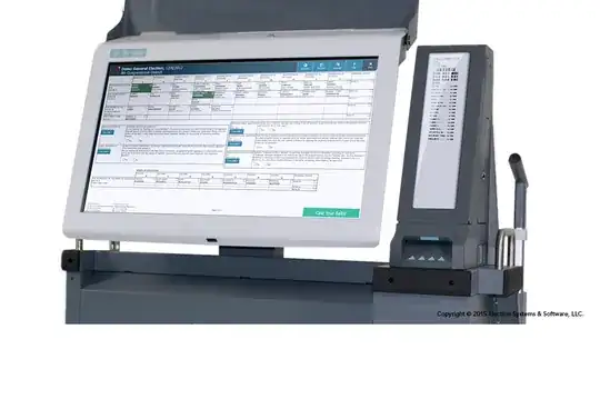

No. I'd like to reword the original question that makes the correct answer blindingly obvious.
Can a voting machine be hacked?
The context.
Let's upgrade to the latest machines in the market (you may have used one of these):-
mc1
mc2
These feature Windows OS, Windows Server and Windows SQL Server software. Perhaps .Net or Visual C++ for the GUI. It's not some little DIY GRUB thing and a bit of assembler. It's literally millions and millions of lines of code running off hard disks, with networking and remote collation/audit/diagnostics across the Internet. Some have WiFi. They're probably remotely up-gradable too. And gigabytes of RAM, not ROM. Security through obscurity will feature heavily as that's a common safety blanket.
Why should they be secure?
There is little financial incentive to rigorously secure these machines due to a combination of DMCA, voter fraud and IP legislation, market dominance and lobbying power. So lets look at a device that has massive incentive to not be hacked - a Play Station. Hacking directly lowers the profitability, yet PS4 has now been hacked.
