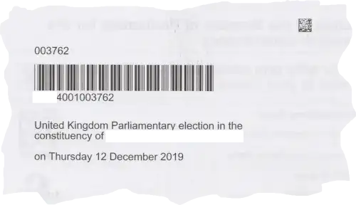

Update:
Regarding voter anonymity in parts #1 and #3, and comments. The following is the back of the current UK Parliamentary Election ballot paper. You may spot the unique bar and QR codes. The bar code is over 70mm long so it's not really a secret. It's not a problem as long as the voting remains paper based.
2019ballot
