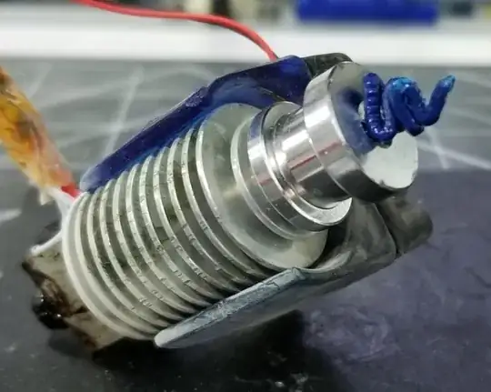

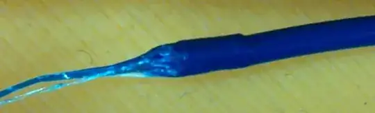

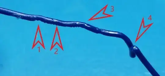

Printer configuration and many settings affect heat creep. Heat creep stopping extrusion doesn't necessarily involve melting the filament too high above the nozzle. All it takes is making the filament too soft. The filament may bend and wad up (the importance to avoid gaps in the hot end allowing this). On direct drives (not Bowden tubes) the filament can get soft so that the teeth on the direct drive cuts a notch in the filament instead of pushing it through the nozzle.

Fig. 1: Some typical signs of heat creep on the filament of a direct drive. 1) notch in filament where gear spins in soft filament. 2) normal teeth marks in filament. 3) soft filament bending. 4) soft filament bunches in open area. With a Bowden tube, the filament widens at the end.
Fig. 2.: Another example of heat creep with a direct drive extruder.

Fig. 3.: Filament with end expanded in nozzle showing jam from filament moving too fast and not heating enough.
