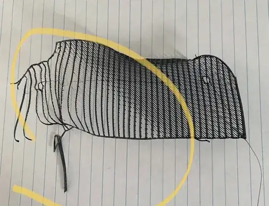

Failed Raft
Figure one highlighting how the filament thins over the course of the raft creation until no more filament is extruded.

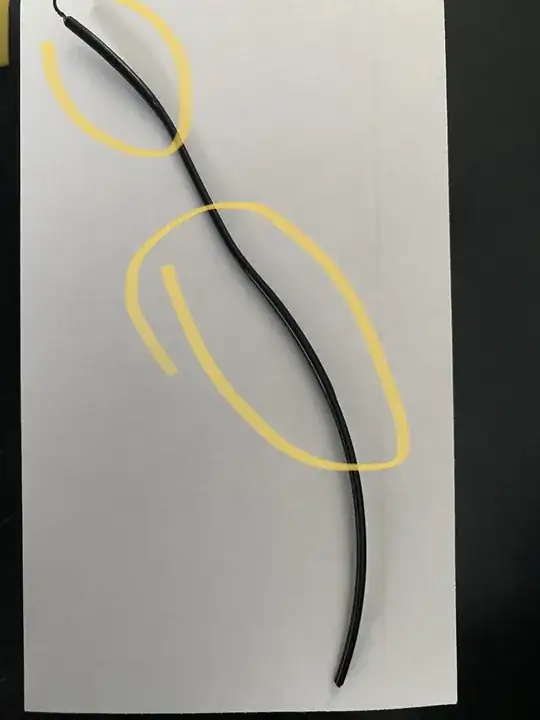

Thickened Filament
Figure two showing how random parts of the filament is thicker than others. The thickness is noticeable and once I cut this section off, filament flows freely through the Bowden tube without friction. With this section, the filament is difficult to remove and requires more force.

If not, the cold end (radiator) of the hot end gets to hot and your filament will soften way too soon. This phenomenon is called heat creep. Looking at the filament you pictured, heat creep is definitely a possible cause. Another good hint is the diminishing filament output.

Your picture of filament shows what people with Bowden extruders describe as typical of heat creep. The Bowden tube isolates the filament drive motor from the temperature of the extruder. On well put together Bowden tube extruder, there is no place for softened filament to bunch up. So, heat creep occurs when the melted filament goes up the region of the heat break in the heat sink. Thus, to determine heat creep one needs to ask, "Is the expanded part of the filament extending into the heatsink.

As you can see on picture 1, on the left-bottom side there is extruded less material than on the right-top side. This, to me, is an indication that your bed might not be flat. When the left-bottom side is a few microns closer to the nozzle than the right-top side, the nozzle will push onto the bed and that prevents it from extruding. A sign of this will be extruder skipping. As you mentioned, keeping the fan at least running slowly during raft creation is always a good idea.
