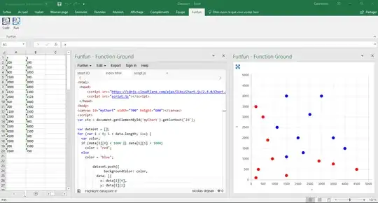

For people with the same problems, there is a usefull tool named FunFun, which allows people to use web languages like Html, Css and JavaScript in Excel.
Javascript has a lot of powerful libraries for data visualization, like Charts.js and D3, that you can use with this Excel add-in to create any chart you want.
If you want to test out different libraries, Funfun hosts an online editor with an embedded spreadsheet, where you can see the output of your code instantly.
I made this chart with Chart.js on the FunFun website that I directly loaded in Excel by pasting the link of the funfun online editor below:
https://www.funfun.io/1/edit/5a32ad9f61242f75d940543f
Here are some screenshots(Website to Excel Add-in):
playground
You then load the project in excel with funfun:
load
code
final
