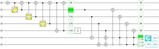

Now consider the Hardy state. What are the magnitudes that we need to make? We need one instance of $3/\sqrt{12}$ and three instances of instance of $1/\sqrt{12}$. We can make them one at a time, by having a "remaining amplitude" state that we keep splitting off of.
We start with all the amplitude in one state with an excitation on the left, $\ell_0 |1000...00\rangle$ where $\ell_0=1$. What we want to do is move the excitation rightward while leaving behind the desired magnitudes. So to start we want to leave behind the magnitude $3/\sqrt{12}$. We can do that with a controlled $R_y(\theta_0)$ operation, where the control is the leftmost qubit and the target is the qubit just to its right. By picking just the right value for $\theta$, this will result in the state $3/\sqrt{12}|1000...00\rangle + \ell_1 |1100...00\rangle$. We then CNOT the second qubit back onto the first qubit to get to $\ell_1|1000...00\rangle + 3/\sqrt{12} |0100...00\rangle$. Next we want to pull off $1/\sqrt{12}$. We perform another $R_y$ controlled by the leftmost qubit followed by a backwards CNOT, but this time with the target is the qubit third from the left. By picking the perfect $\theta_1$ we will produce the state $\ell_2|1000...00\rangle + 3/\sqrt{12}|0100...00\rangle + 1/\sqrt{12} \ell_2 |0010...00\rangle$. And you just keep doing this until you've got all the amplitudes you need, conveniently addressed by individual qubits being excited.
Now you want to fix any incorrect phases produced by the Y rotations. For the Hardy state this is easy, because all the phases are positive. In general you target each qubit position $k$ with an $R_z(\phi_k)$ operation with appropriately chosen $\phi_k$ values, and that will get the phases right.
Now we want to get the ordering right. The easiest way to do this is to have some extra qubits that are your output qubits and, for each of the qubits we've prepared so far and each of the output qubits, either add a CNOT between the two or don't. For example, if the state with amplitude $3/\sqrt{12}$ is supposed to be a $|11\rangle$, then we need to CNOT from our leftmost qubit onto both of the output qubits. Then we need to uncompute the leftmost qubit by using a many-controlled NOT operation. There should be one control for each output qubit, and the control's type (qubit-must-be-on vs qubit-must-be-off) is determined by whether or not you toggled the qubit.
Applying these steps produces an inefficient, but correct, circuit for creating a Hardy state. You can open the circuit in Quirk:
Simple preparation
