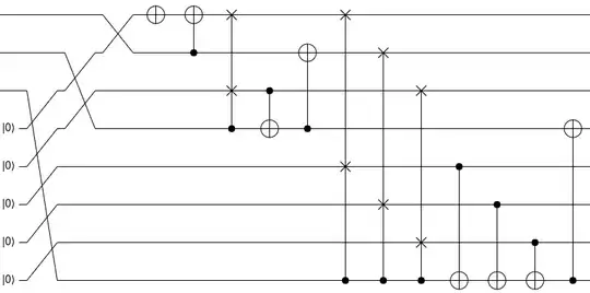

Yes, there are several implementations of this algorithm in the Superposition quantum kata (tasks 14 and 15):
  • For $n = 2^k$, you can use a recursive algorithm: create a W state on the first $2^{k-1}$ qubits, allocate an ancilla qubit in $|+\rangle$ state, do some controlled SWAPs to set the state of the second $2^{k-1}$ qubits, and then some controlled NOTs to reset the ancilla back to $|0\rangle$ (WState_PowerOfTwo_Reference operation).
  • For an arbitrary $n$, you can use a recursive algorithm as described by DaftWullie (WState_Arbitrary_Reference operation).
  • There is also a neat trick you can use to create a $W_n$ state for an arbitrary $n$ using the first recursive algorithm. Allocate extra qubits to pad the $n$ given ones to $2^k$, create a state $W_{2^k}$ on them and measure the extra qubits; if all qubits measure to 0, the state of the original qubits is $W_n$, otherwise reset and repeat the process (WState_Arbitrary_Postselect operation).
This is my favorite task of that kata, because it allows so many different approaches.

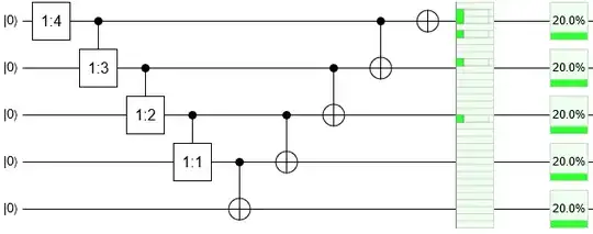

The conceptually simplest way to produce a W state is somewhat analogous to classical reservoir sampling, in that it involves a series of local operations that ultimately create a uniform effect.
Basically, you look at each qubit in turn and consider "how much amplitude do I have left in the all-0s state, and how much do I want to transfer into the just-this-qubit-is-ON state?". It turns out that the family of rotations you need is what I'll call the "odds gates" which have the following matrix:

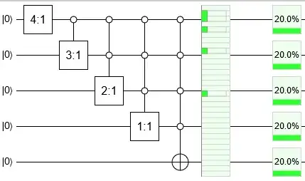

Using these gates, you can get a W state with a sequence of increasingly-controlled operations:
transfer-out-of-0
This circuit is somewhat inefficient. It has cost $O(N^2 + N \lg(1/\epsilon))$ where $N$ is the number of qubits and $\epsilon$ is the desired absolute precision (since, in an error corrected context, the odds gates are not native and must be approximated).
We can improve the efficiency by switching from a "transfer out of what was left behind" strategy to a "transfer out of what is traveling along" strategy. This adds a fixup sweep at the end, but only requires single controls on each operation. This reduces the cost to $O(N \lg(1/\epsilon))$:
transfer-out-of-1

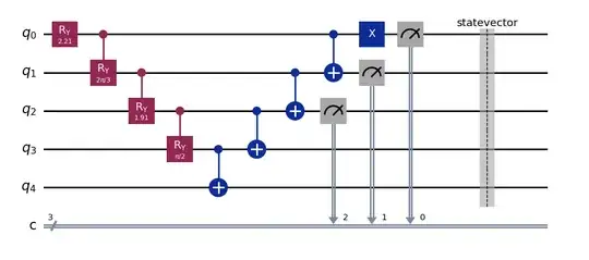

This function creates a W_n circuit using the ideas in the second part of Craig Gidney's answer above with m measuring-gates. If m = n-2, we can then perform a CHSH test on the entanglement of the residual two unmeasured gates. Based on qiskit 1.3.4.
from qiskit import QuantumCircuit, QuantumRegister, ClassicalRegister
def create_wn_state(n,m): qr = QuantumRegister(n, 'q') cr = ClassicalRegister(m, 'c') circuit = QuantumCircuit(qr, cr)
# For n=4, we want amplitude ratios of 1:3, then 1:2, then 1:1 (etc)
# Calculate angles to achieve these splits
for i in range(n-1):
    theta = 2 * np.arccos(np.sqrt(1/(n-i)))
    if i == 0:
        circuit.ry(theta, qr[0])
    else:
        circuit.cry(theta, qr[i-1], qr[i])
# Second loop: CNOTs in descending pairs
for i in range(n-1, 0, -1):
    circuit.cx(qr[i-1], qr[i])
# Final X gate on first qubit
circuit.x(qr[0])
# Only measure first m qubits
for i in range(3):
    circuit.measure(qr[i], cr[i])
return circuit
Output: W_5 with 3 measured qubits
Running the measurements with 1024 shots produces output such as
value: 000; frequency = 398 (includes 01000 and 10000)
value: 001; frequency = 188
value: 010; frequency = 212
value: 100; frequency = 226
