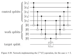

A recent question here asked how to compile the 4-qubit gate CCCZ (controlled-controlled-controlled-Z) into simple 1-qubit and 2-qubit gates, and the only answer given so far requires 63 gates!
The first step was to use the C$^n$U construction given by Nielsen & Chuang:
With $n=3$ this means 4 CCNOT gates and 3 simple gates (1 CNOT and 2 Hadamards is enough to do the final CZ on the target qubit and the last work qubit).

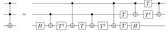

Theorem 1 of this paper (PDF / arXiv), says that in general the CCNOT requires 9 one-qubit and 6 two-qubit gates (15 total):
This means:
(4 CCNOTs) x (15 gates per CCNOT) + (1 CNOT) + (2 Hadamards) = 63 total gates.
