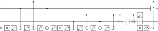

Here is a CCCZ construction that uses 29 gates:
circuit
If you're allowed to use measurement and classical feedforward, the gate count can be reduced to 25:
circuit
(The Hadamard gates can be replaced with square roots of Y if needed to meet the gate set constraint.)

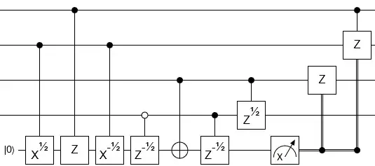

And if you allow me to perform Controlled-S gates and Controlled-sqrt(X) gates and perform X basis measurements, then I can get it down to 10 gates total:
circuit

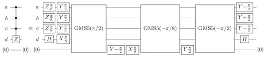

You can implement an $n$-qubit controlled $U$ by the circuit given in this answer. Just replace $U$ by $Z$. However this requires CCNOT (Toffoli) gates, and you have some options for how to implement CCNOT using elementary gates.
I'm posting another decomposition of CCCZ here just in case it is useful for anyone else trying to compile CCCZ. It requires a smaller number of total gates, and only 1 auxiliary qubit instead of 2, but five more 2-qubit gates than the "obvious" answer, so may actually be worse for implementation on Hardware.
It was suggested by user @Rob in this comment: Automatic compilation of quantum circuits, and comes from this paper.
The GMS5$(\chi)$ gate is this:
with $n=5$ and all $\chi_{ij}=\chi$, which means it involves 10 two-qubit gates. These will then have to be compiled into the gate set given in the question, so this decomposition should only be used if you are trying to save on the number auxiliary qubits or if you don't mind having more 2-qubit gates in order to reduce the circuit depth by a bit.
