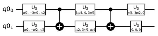

Given that the
$$\sqrt{iSWAP} = \begin{pmatrix} 1 & 0 & 0 & 0\\ 0 & 1/\sqrt{2} & i/\sqrt{2} & 0 \\ 0 & i/\sqrt{2} & 1/\sqrt{2} & 0 \\ 0 & 0 & 0 & 1 \end{pmatrix} $$
then we can use the decompose method in qiskit to get the set of elementary gates that would be implement on IBM hardware, which comes out to be:
You can use quirk to do the something similar I believe. Now, recently IBM changes its native set of gates to $\{ CZ, ID, RZ, SX, X \}$. So to see how this being implement on the hardware you can use the transpilation method. Which will transpile the above circuit to the following circuit on 'ibmq_athens':
If you wish to do the decomposition within qiskit, you can use the following script:
from qiskit.quantum_info.operators import Operator
from qiskit import QuantumCircuit, QuantumRegister
import numpy as np
sqrt2 = np.sqrt(2)
controls = QuantumRegister(2)
circuit = QuantumCircuit(controls)
Matrix = Operator( [
    [1, 0, 0, 0],
    [0, 1/sqrt2, 1j/sqrt2, 0],
    [0, 1j/sqrt2, 1/sqrt2, 0],
    [0, 0, 0, 1] ])
circuit.unitary(Matrix, [0,1])
decomp = QuantumCircuit.decompose(circuit)
print(decomp)
