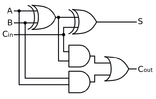

Here is my process for doing arithmetic on a quantum computer.
Step 1: Find a classical circuit that does the thing you're interested in.
In this example, a full adder.
classical full adder

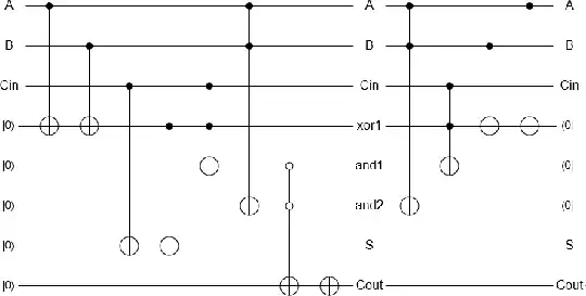

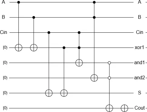

Step 2: Convert each classical gate into a reversible gate.
Have your output bits present from the start, and initialize them with CNOTs, CCNOTs, etc.
semi-reversible full adder
Step 3: Use temporary outputs.
If you were doing this addition to e.g. control whether a Grover oracle phases by -1 or not, now is the time to apply a Z gate to your output qubit.
Step 4: Get rid of intermediate values by doing exactly the opposite of what you did to compute them.
This may or may not include getting rid of the output bits, depending on how the circuit fits into your overall algorithm.
semi-reversible full adder 2

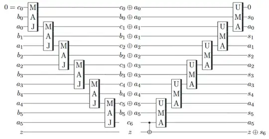

Step 6: Be efficient
In step 5 I said you could uncompute the input of an inplace addition by doing an out of place addition followed by a temporary out-of-place subtraction. This is a bit silly. The overall adding process is going to span 4n qubits (n to hold a, n to hold c, n to hold c+a, n to hold (c+a)-a). If you are more clever, you can fit everything into 2n qubits or (slightly easier) into 2n+1 qubits:
cuccaro adder
