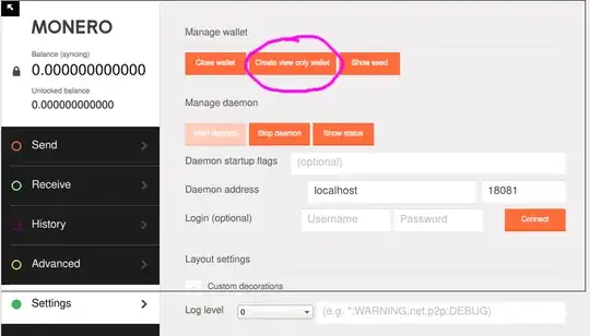

Yes, it is possible since monero-gui-0.10.3.1-beta2 release.
Open your wallet from the GUI, and in the Settings tab you have the Create view only wallet button.

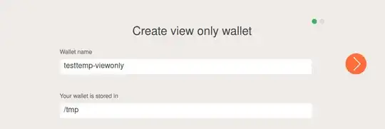

Click on it, and a window will show up letting you choose the name of the view-only wallet file and its location.

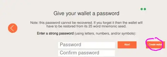

Give it a password,

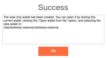

and you will see a confirmation that it has been created.
