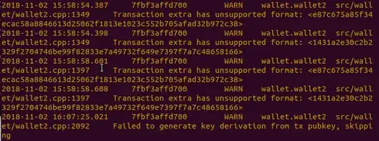

this is the same error received in v0.13.0.3 GUI
txn extra has unsupported format
all transactions are pre fork by weeks, and is leading to an incorrect balance showing in my wallet.
Re synced the blockchain from scratch post fork. rescan_bc in CLI and refreshed the GUI from genesis, both showing the same incorrect balance after complete wallet refresh. monerod is fully synced and wallet is in sync with monerod.
linux x64, virtual machine, v0.13.0.4

I have a theory that I'm posting as an answer.
I think you clone and build monero yourself. And I think you're using the same startup sequence to launch monero-wallet-gui as you did previously. And I think what happened is you didn't realize that new builds are being put in a different directory hierarchy in the /build directory. So when you launch monero-wallet-gui, your computer is using the PATH you previously set (build/release/bin), meaning you keep launching the old software.
