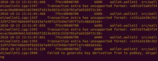

Both wallet and CLI are showing the incorrect balance after many full blockchain rescans, trying with the CLI, same result, rescan from genesis block and arbitrary block numbers, same result.
Full balance was there before the fork, and after the fork, a few txns made well before the fork (1 week+) have been rejected which makes up a significant portion of my balance. I know the funds are still there but the wallet cannot "see" them.
x64 ubuntu 18.04, V0.13.0.3, monerod running with GUI on top
gui terminal export ubuntu x64 18.04

Your transaction has an ADDITIONAL_PUBKEYS tag in the tx_extra field. This means it was a transaction with at least two destinations, at least one of which was a subaddress.
These warnings mean that your wallet does not know how to interpret this ADDITIONAL_PUBKEYS tag. Therefore your wallet must be an older wallet version that does not support subaddresses. Please check that you're using the latest GUI wallet.
