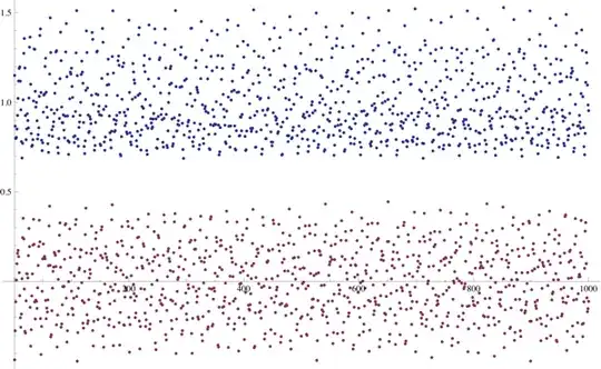

Here is a plot of the real and imaginary parts of the first $1000$ terms:
The real part (in blue) is centered on $1$ because of the first term.

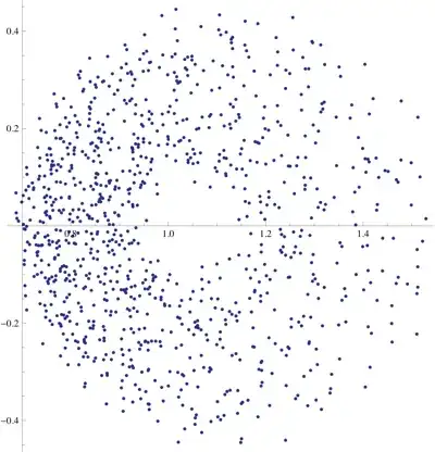

Here is a plot of the $1000$ terms in the complex plane:
The vacancy near $1$ is to be expected, but the asymmetry in $x$ is interesting.
