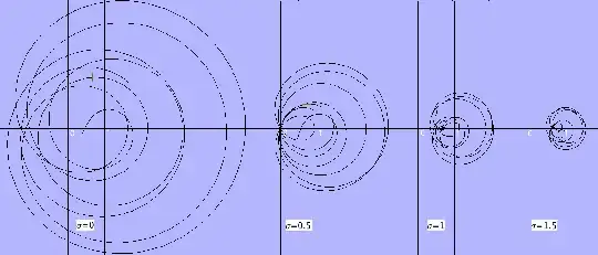

Let's begin with a picture of the complex orbits $\;t\in (2,42)\mapsto\zeta(\sigma+it)\;$ for $\,\sigma=0, \dfrac 12, 1,\dfrac 32$ respectively :
Qualitative discussion :
- for $\;\sigma<\dfrac 12\;$ the loops turn around the origin $0$ (for negative values of $\sigma$ the loops look more and more like an outgoing spiral)
- as $\;\sigma\;$ approaches $\dfrac 12$ all the loops miraculously cross (or seem to cross...) the origin (to simplify the 'wording' I'll suppose the R.H. true!)
- for larger values of $\;\sigma\;$ the loops will concentrate more and more near the value $1$.
If we imagine a line going from the origin to the complex point $\zeta(\sigma+it)$ we may conjecture that for $\,\sigma\le \dfrac 12\,$ the (continuous) phase will decrease (the rotation being clockwise for $t\gg 1$) indefinitely as $t\,$ grows while for larger values of $\sigma$ the phase will only oscillate between $-\pi$ and $+\pi$.

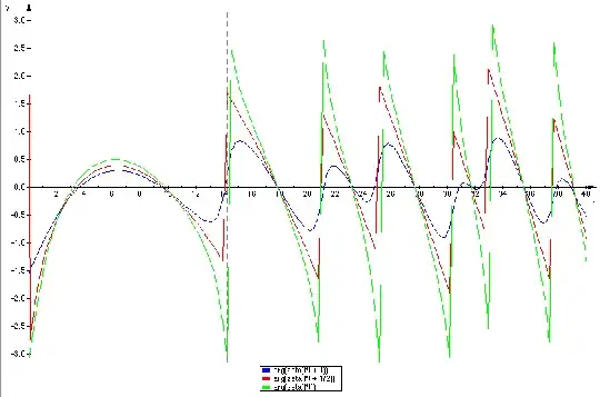

The following green, red and blue curves show the principal argument for $\,\sigma=0, \dfrac 12, 1\,$ :
The principal argument is illustrated instead of the (continuous) phase (both were illustrated in your link for $\,\sigma=\dfrac 12$). This implies that there will be a jump of $\pm\pi$ for every zero of $\,\zeta\,$ and a jump from $-\pi$ to $+\pi$ after each loop for $\sigma<\dfrac 12$.
In the case $\sigma=\dfrac 12\,$ the phase is known as the very regular Riemann–Siegel theta function $-\theta(t)$ from $\,\displaystyle\zeta\left(\frac 12+it\right)=Z(t)\,e^{-\large{i\theta(t)}}\;$ (c.f. your link or the demonstration to follow). Anyway, from the picture, we may doubt that such a simple solution exists in the case $\,\sigma=1\,$ or even $\,\sigma\neq\frac 12$...
The phase for $\,\sigma=1\,$ appears to 'follow' the principal argument of $\,\zeta\,$ for $\sigma=\dfrac 12$ and thus to have the complexity of the amplitude $Z(t)$ rather than the simplicity of the phase $-\theta(t)$.
