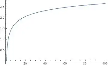

To answer this question, one must note that by generating a random number from a distribution with cumulative distribution function $F$, one is uniformly sampling the y-axis and choosing the x-axis value. Hence, we should first find the corresponding $x$-value of the partition chosen, that is $$\frac{1}{{\sqrt {2\pi } }}\int\limits_x^{ + \infty } {{e^{ - \frac{{{t^2}}}{2}}}dt} = \frac{M}{N}$$which yields $$x = \sqrt 2 {\rm{InverseErfc}}\left( {\frac{{2M}}{N}} \right)$$Now, all we have to compute is the expected value of $x$ in this range, that is $$\begin{array}{c}{\rm{Answer}} = \frac{{\frac{1}{{\sqrt {2\pi } }}\int\limits_{\sqrt 2 {\rm{InverseErfc}}\left( {\frac{{2M}}{N}} \right)}^{ + \infty } {t{e^{ - \frac{{{t^2}}}{2}}}dt} }}{{\frac{1}{{\sqrt {2\pi } }}\int\limits_{\sqrt 2 {\rm{InverseErfc}}\left( {\frac{{2M}}{N}} \right)}^{ + \infty } {{e^{ - \frac{{{t^2}}}{2}}}dt} }}\\ = \frac{N}{{\sqrt {2\pi } M}}{e^{ - \frac{{{{\left( {{\rm{InverseErfc}}\left( {\frac{{2M}}{N}} \right)} \right)}^2}}}{2}}}\end{array}$$A plot could be constructed for this problem by defining $u = \frac{N}{M}$ and noticing that $1 \le u < + \infty $ enter image description here Hope it helps ;)
