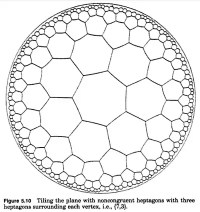

There is a way to cover the entire plane with convex heptagons. The one in the center is regular, then a ring of seven of them are almost regular. The next ring out are already pretty long and narrow, and so on.
From the point of view of your question, the key fact is that these are not all congruent. I'm not sure the word "tessellation" would be correct here.
This construction has been known for a very long time, it is in page 77 in Mathematical Snapshots by H. Steinhaus, probably plenty of other books and web pages. STEINHAUS
Evidently it is also discussed on pages 248-249 of GARDNER
I'm afraid I have been unable to find an image on line. The closest I have found in in $\mathbb H^2,$ see the tiling called (7,3) at HYPERBOLIC and imagine what would happen if the whole thing were stretched radially, in polar coordinates $(r,\theta) \rightarrow \left( \tan \frac{\pi r}{2},\; \theta \right).$ I should admit that I do not really know whether this gives a good approximation of the covering of $\mathbb R^2$ beyond the first three or four rings depicted. Probably not.
Will Jagy
  • 146,052
  • Do you know if this is explicitly based around the tiling of the hyperbolic plane? I could easily see some scheme that would start with the (7,3) tiling as represented in the Klein disc model (where all edges are straight lines) and then blow it up non-conformally in some fashion that maintains both the linearity (maybe by simply keeping track of points and redrawing the edges?) and the convexity... – Steven Stadnicki Dec 15 '11 at 23:15
  • @StevenStadnicki , I really have no idea. There is a clear resemblance near the center, as there must be. I do not know how much work would be required either to confirm your idea or rule it out. If you know anyone with the software, maybe do a larger subset of of (7,3) and see if you can get some radial mapping to work out well. I'm uneasy about the behavior of geodesics that never get near the origin. Even the arrangement of polygons in obvious rings seems unclear in (7,3) as we go farther out, while that is the most important feature of the Steinhaus diagram. – Will Jagy Dec 15 '11 at 23:40
  • Will: do you know of a good diagram online? The easiest way to confirm would likely be via counting the number of heptagons at distance 'n' (measured in the dual graph, i.e. how many tiles need to be stepped through) from the center. I've looked at similar sequences for the (5, 4) tiling and I don't imagine they'd be too hard to tally here. – Steven Stadnicki Dec 16 '11 at 00:00
  • @StevenStadnicki no, I'm afraid I was unable to find this online with a diagrm, the only mention so far is at http://mathworld.wolfram.com/Tiling.html and quite brief. – Will Jagy Dec 16 '11 at 00:11

As a supplement to Will Jagy's answer, permit me to include two figures. The first image below is from Jay Kappraff's 1990 book, Connections: the geometric bridge between art and science. The second image is from a 1983 paper by Danzer, Grünbaum, Shephard, "Does Every Type of Polyhedron Tile Three-Space?" in Structural Topology 8 (perhaps the source for Kappraff?).
           Heptagons 1
           Heptagons 2
  • Joseph, thanks. That is Steven Stadnicki's question, is there a (radial) mapping of the hyperbolic (7,3) tiling that results in, more or less, the Steinhaus-Danzer-Grunbaum-Shephard diagram, which is arranged in obvious concentric rings. Steinhaus forces two edges of each heptagon to be radial, I see your diagram is not doing that. – Will Jagy Dec 18 '11 at 03:35
