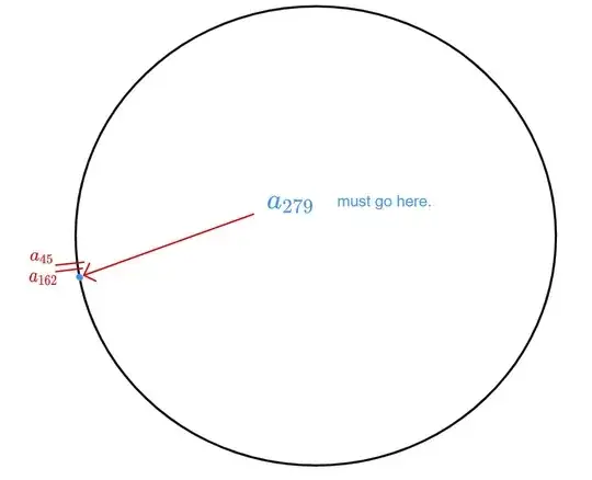

A pictoral representation of mm-aops's proof. I also avoid use of: "the distance from $a_n$ to $a_m$ is the same as between $a_{n-m}$ and $a_0 = 0$."
Let $\ \varepsilon = \frac{1}{200}.\ $ Then, we split the circle up into $201$ arcs of equal length. Think of these arcs as "boxes" in the sense of the pigeonhole principle: then there must be $\ n,m \leq 201\ $ such that $\ \mid a_{n} - a_m\mid \leq \frac{1}{201} <\varepsilon.$
Suppose the first two such $\ n,m\ $ are $\ a_{45}\ $ and $\ a_{162}\ .$
Any point on the circle must lie within $\ \varepsilon=\frac{1}{200}\ $ distance from $\ a_{45}\ $ or $\ a_{162}\ $ or $\ a_{279}\ $ or $\ a_{396}\ $ or ...
