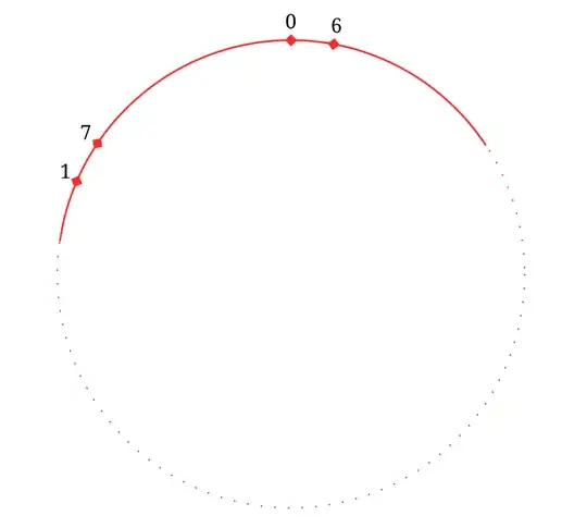

$0$ is marked for the fixed point.
$1$ is marked for the point when you rotate the circle by $1$ radian about its center.
When you rotate the circle by $7$ radians, the new marked point is looked like in the picture below: enter image description here
