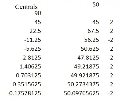

We can find exact value of tan 50∘ (and other integer angles and polygons) using Precise-Rewritten method. The result will be in repeated nested radicals.
For this our target angle is 50∘. Make a table having three columns starting from 90∘ (called as Central):
First column is the Central and its halves. Each Central requires to add or subtract towards target angle (A, which is 50∘ in this case).
Second column is the cumulative of the first column excluding 90∘. We need to reach to the target angle A in this column.
Third column is just $\frac{previous Central}{current Central}$, which is, always, either +2 or -2. Let us see the calculation as:enter image description here
In the table, we can see there is repetition of +2-2+2. We are lucky, we are near to the exact radical values for Sin 50∘.
Now, gather the result from the third column as: $$+2 \overline {+2 - 2 + 2}$$.
Replace each by √(2 as: $$√(2 \overline {+√(2 -√(2 +√(2}$$.
Half of this is Sin 50∘ as $$\frac{1}{2}√(2 \overline {+√(2 -√(2 + √(2} ]$$ Subtract the whole thing after first radical, it will be Cos 50∘ as $$\frac{1}{2}√(2 - \overline {+√(2 -√(2 + √(2}]$$
Now,we can use classical formula for $\tan 50∘$, although Precise-Rewritten method prescribed something else. $$\tan 50∘ = \frac{\frac{1}{2}√(2 \overline {+√(2 -√(2 + √(2} ]}{\frac{1}{2}√(2 - \overline {+√(2 -√(2 + √(2}]}$$
Therefore, $$\tan 50∘ = \frac{√(2 \overline {+√(2 -√(2 + √(2} ]}{√(2 - \overline {+√(2 -√(2 + √(2}]}$$
