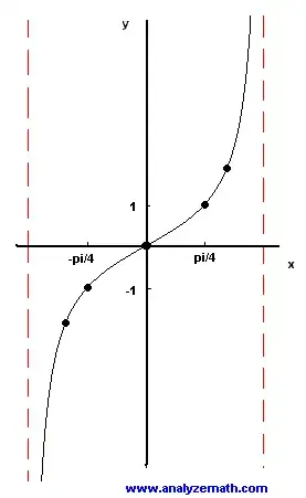

The $\tan$ function is growing on $\left[0,\frac{\pi}2\right[$
We also know that $\tan(\frac{\pi}4)=1$ and $50°>\frac{\pi}4=45°$
What is more around $\frac{\pi}4$ the function has a slope of about 1, therefore a $5°$ difference won't induce a big difference between $\tan(45°)$ and $\tan(50°)$.
Therefore $\tan(50°)$ is a little bigger than $1$ which is answer $3$.

Let me work with radians and let us have a look to $\tan(\frac{5\pi}{18})$. We can write $$\tan(\frac{5\pi}{18})=\tan(\frac{\pi}{4}+\frac{\pi}{36})$$ At this point, we could apply the formula for $\tan(a+b)$ and conclude. Another way is to develop $\tan(x)$ as a Taylor series at $x=\frac{\pi}{4}$ and get $$\tan(x)=1+2 \left(x-\frac{\pi }{4}\right)+O\left(\left(x-\frac{\pi }{4}\right)^2\right)$$ If we use $x=\frac{\pi}{4}+\frac{\pi}{36}$, we then have $$\tan(\frac{5\pi}{18}) \simeq 1+\frac{\pi}{18} \simeq 1.17453$$ while the exact value is $1.19175$.
Another solution is to draw the circle, the line corresponding to the two angles and observe where are located the values of the respective tangents.
