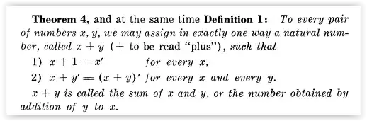

The book is Foundations of Analysis by E. Landau.
I delve into analysis for the first time. Before I would encounter merely a definition of something in a textbook, but now there is something more. In Theorem 4 the author gives a definition of addition. Then he first proves that A) for any fixed $x$ there is at most one possibility to define $x + y$. Then he proves that B) for each $x$ it is possible to define $x + y$.
My question is why does he prove B) that it is possible to define $x + y$? He has already made a definition, so he brought it into existence.
Why does he need proofs here at all? It is a definition, you can define it however you want.

  • A quick note. You can't just define it however you want, it has to be consistent. – The very fluffy Panda May 06 '14 at 17:59
  • How does the author define addition? – Dan Christensen May 07 '14 at 03:11
  • @DanChristensen: This Theorem 4 is the definition of addition in disguise. – mosceo May 07 '14 at 10:54
  • @Graduate I get it, now. I'm curious... Does Landau start his proof by selecting the same subset of $N^3$ that I do? Or does he make use of some recursion theorem? – Dan Christensen May 07 '14 at 14:58
  • I found an excerpt that contains at least the beginning of the "proof". It doesn't seem do either of these things. I can't make any sense of it. http://fmi.unibuc.ro/ro/pdf/2008/catedre/analiza/miculescu_r/Landau.pdf – Dan Christensen May 07 '14 at 19:24
  • A full quotation of the proof at http://www.lib.uni-bonn.de/PhiMSAMP/Data/Book/PhiMSAMP-bk_Borovik.pdf (p. 4-5) It still doesn't make any sense. – Dan Christensen May 07 '14 at 19:45
  • @DanChristensen: It was written 60 years ago, maybe that's why it is a bit strange. But it must be correct. Tom Apostol recommended Landau's book in his Calculus. – mosceo May 07 '14 at 20:38
  • @DanChristensen I was in the middle of writing a very detailed response to your other question (about Landau's definition of addition) but the question was deleted and I was in the middle of composing it. Do you still have questions about it? – mweiss May 08 '14 at 15:16
  • @mweiss Sorry. I have now undeleted. I mistakenly thought there was no interest in the question. Yes, I am still interested in an answer. – Dan Christensen May 08 '14 at 19:35
The proof is necessary to ensure that the definition is actually meaningful.
Suppose, for instance, that I define a binary operation $\circledast$ on $\mathbb{Q} \times \mathbb{Q}$ as follows: For any rational numbers $q_1$ and $q_2$, I say that $q_1 \circledast q_2$ is the smallest rational number greater than $q_1 \cdot q_2$. Great! Only problem is, no such smallest rational number exists.
Second example: I define a ternary operation $F$ on $\mathbb{R} \times \mathbb{R} \times \mathbb{R}$ as follows: $F(a,b,c)$ is the solution to the equation $a x^2 + bx + c = 0$. Terrific! Only problem here is, sometimes no such solution exists, and sometimes more than one solution exists.
Whenever you define something, it's essential to prove that the thing being defined both exists and is unique. Otherwise the definition is meaningless.

We don't have to simply define addition and hope we get it right. We can actually prove the existence a uniquely defined add function on $N$ with all the required properties.
We can formally construct the $add$ function on the set of natural numbers $N$ by selecting the following subset of $N^3$:
$\forall a,b,c:[(a,b,c)\in add \iff (a,b,c)\in N^3 $
$\land \forall d\subset N^3:[\forall e\in N:(e,0,e)\in d\land \forall e,f,g:[(e,f,g)\in d \implies (e,S(f),S(g))\in d]$
$\implies (a,b,c)\in d]]$
where $S$ is the successor function on $N$ given by Peano's Axioms.
Using Peano's Axioms, we can prove that the set of ordered triples $add$, so defined, is a function such that, using the prefix functional notation, we have:
$\forall a,b\in N: add(a,b)\in N$
$\forall a\in N:add(a,0)=a$
$\forall a,b\in N:add(a,S(b))=S(add(a,b))$
We can also prove that the $add$ function, so defined, is unique. If $add'$ is another function such that we also have:
$\forall a,b\in N: add'(a,b)\in N$
$\forall a\in N:add'(a,0)=a$
$\forall a,b\in N:add'(a,S(b))=S(add'(a,b))$
then we can prove by induction that $\forall a,b\in N: add(a,b)=add'(a,b)$
We then feel justified referring to the add function + (using the infix notation) where
$\forall a,b\in N: a+b\in N$
$\forall a\in N:a+0=a$
$\forall a,b\in N:a+S(b)=S(a+b)$
