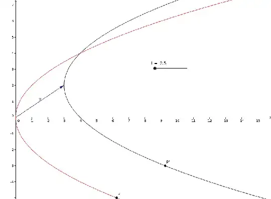

Applying a translation
Now consider the following translation $$ \begin{cases} x=X+h\\ y=Y+k \end{cases} \quad\equiv\quad \begin{cases} X=x-h\\ Y=y-k \end{cases} $$ Applying this transformation to our case (aka substitution) gives the parabola $$(y-k)^2=4a(x-h)^2$$ and the respective parametric representation $$ \begin{cases} x-h=at^2\\ y-k=2at \end{cases} \implies \begin{cases} x=h+at^2\\ y=k+2at \end{cases} $$
These equations, in the $xy$-plane, represent a parabola identical to the previous one, only shifted by a vector $\mathbf{v}=(h,k)$. Moreover every value $t$ yields a point $P'(t)=(h+at^2,k+2at)$ on the second parabola. Notice that $$ P'(t)=P(t)+\mathbf{v}\qquad\forall t\in\mathbb{R}$$

A visual aid
The gif here below represents the $XY$-plane and the $xy$-plane overlapping each other. You can see the original parabola (red), the shifted one (black), and the points $P(t)$ and $P'(t)$ (for this example I set $a=1$, $h=3$, $k=2$).
Shifted parabolas and points on them

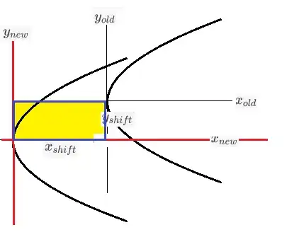

Let the parametrization $ (f(t),g(t))$ be anything, it doesn't matter... it is just a simple translation parallel to axes, meaning addition or subtraction of $(x,y)$ coordinates of any curve in order to get to the new pair from the old pair.
In this case it is a particular case of a parabola with $x$ axis of symmetry, $t=0$ corresponding to the vertex of parabola described by old pair.
$$ x_{new}= x_{shift} + f(t);\quad y_{new} =y_{shift}+ g(t); $$ $$ x_{new}= x_{shift} + x_{old}\,;\quad y_{new} =y_{shift}+ y_{old}\,;$$
Dynamically it is motion of a particle starting from origin when gravity acts along old $x-$ axis:
$$ \,x= a t^ 2, y= 2 a t,\,$$
where $t$ is not time but reciprocal of varying slope of the parabola of focal length $a$.
The very same motion is given by new axes with new parametrization if you reckon with new shifted datum. In the new case the old trajectory of course just does not exist.
