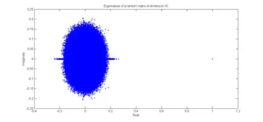

EDIT: It is also important to know that randomly generating a stochastic matrix in Matlab (shown in the figure below) yields a relatively small second-largest eigenvalue, indicating that the probability of having large second-largest eigenvalue is small and it needs to be crafted. You can also see the eigenvalue $1$ that always exists in isolation on the far right. The figure below is the spectra of $10000$ randomly generated $16 \times 16$ stochastic matrices. enter image description here

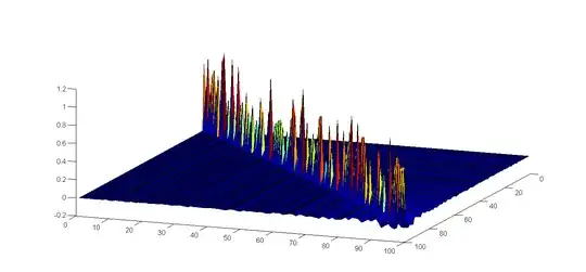

As pointed out in the comments, I found a paper that constructs a doubly stochastic matrix explicitly from a given positive spectrum. However, the constructed matrices are, in fact, very concentrated around the diagonal (these can be called lazy Markov chains since they tend to stay where they are). This result explains why it is extremely unlikely that a randomly generated stochastic matrix would have eigenvalues closer to $1$ than shown in the above figure. This means there is only local transitions between Markov chain states with very weak global transitions. Is that indeed implied by asking for large eigenvalues of the transition matrix?
Here is a surface plot of a $100 \times 100$ stochastic matrix constructed from a randomly generated positive spectrum as explained in this paper.
