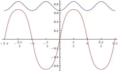

This is not a solution, but here's a pretty compelling picture of the the fourth iterates of cosine and sine (in blue and red, respectively).
It suggests that you can't uniformly bound the two apart from one another. (The functions appear to have slightly overlapping ranges).
Sammy Black
  • 28,409
    As I said, I know that picture. But I'm looking for a formal argument. – user129798 Feb 18 '14 at 21:49
    You can turn the picture into a formal argument.
    1. The functions are $2\pi$-periodic, so it suffices to check on $[-\pi,\pi]$.
    2. Clearly one is negative on $[-\pi,0]$ while the other is positive, so it suffices to check on $[0,\pi]$.
    3. $\mathrm{cos}(\mathrm{cos}(\mathrm{cos}(\mathrm{cos}(x))))$ is injective on this domain, so it's easy to compute exactly when it dips below $\mathrm{sin}(\mathrm{sin}(\mathrm{sin}(1)))$, which is the maximum of the other function. Then you make sure they don't intersect on this domain.
    – Michael Kasa Feb 18 '14 at 22:01
    Probably he wanted to know how this problems was supposed to be solved, since in this kind of contest you don't get pictures or wolframalpha :-) Usually you can't even bring a calculator ;-) – Ant Feb 18 '14 at 23:23
