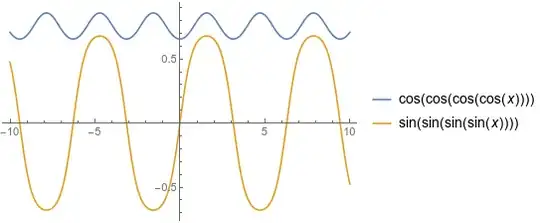

We can also see this from a plot of the two iterated functions.
Mathematica graphics
The upper bound of the orange trace is higher than the lower bound of the blue trace, but whenever the orange trace is $\geq 1/2$, the height of the blue trace is at least $0.698{\dots}$, which is above the upper bound of the orange trace ($0.678{\dots}$).
