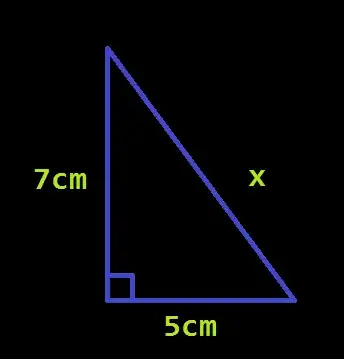

Today we learned about Pythagoras' theorem. Sadly, I can't understand the logic behind it.
$A^{2} + B^{2} = C^{2}$
$C^{2} = (5 \text{ cm})^2 + (7 \text{ cm})^2$
$C^{2} = 25 \text{ cm}^2 + 49 \text{ cm}^2$
$C^{2} = 74 \text{ cm}^2$
${x} = +\sqrt{74} \text{ cm}$
Why does the area of a square with a side of $5$ cm + the area of a square with a side of $7$ cm always equal to the missing side's length squared?
I asked my teacher but she's clueless and said Pythagoras' theorem had nothing to do with squares.
However, I know it does because this formula has to somehow make sense. Otherwise, it wouldn't exist.

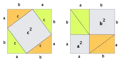

Ponder this image and you will see why your intuition about what is going on is correct:
Bulberage
  • 2,264
  • 43
    This is all correct and this is how one can prove PT, with one caveat: This proof assumes that we have a well-developed notion of area. Proving (from Euclid's axioms) that area for convex polygons satisfies the property that area of subdivided polygon is the sum of areas of pieces (so that the area of rectangle is the product of its sides) is harder than it looks. There is a more elementary but less intuitive proof of PT using similarity of triangles. – Moishe Kohan Feb 13 '14 at 20:53

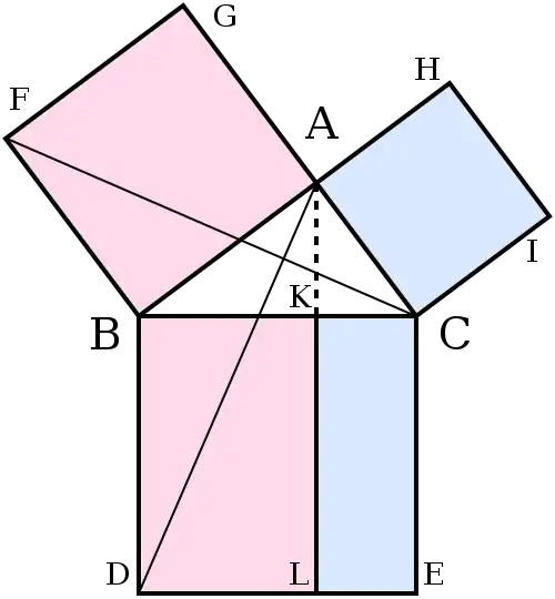

    @studiosus Indeed! Euclid proves this by splitting the squares on the legs into parts that fill the square on the hypothenuse. So no “sums of areas”, just equidecomposability. – egreg Feb 13 '14 at 22:12

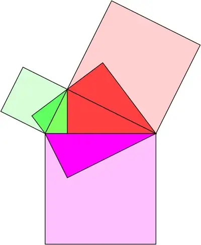

It is not quite important that the shapes of the figures you put on the edges of your right triangle are squares. They can be any figure, since the area of a figure goes with the square of its side. So you can put pentagons, stars, or a camel's shape... In the following picture the area of the large pentagon is the sum of the areas of the two smaller ones:

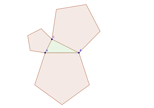

I'm am not able to rescale Camels with geogebra... so here are pentagons
But you can also put a triangle similar to the original one, and you can put it inside instead of outside. So here comes the proof of Pitagora's Theorem.

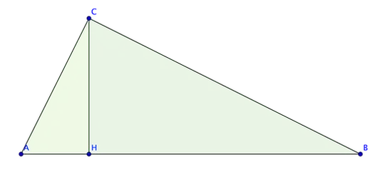

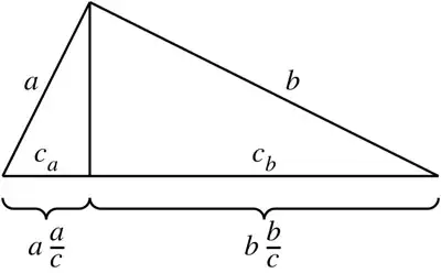

Let $ABC$ be your triangle with a right angle in $C$. Let $H$ be the projection of $C$ onto $AB$. You can easily notice that $ABC$, $ACH$ and $CBH$ are similar. And they are the triangles constructed inside the edges of $ABC$. Clearly the area of $ABC$ is the sum of the areas of $ACH$ and $CBH$, so the theorem is proven.
In my opionion this is the proof which gives the essence of the theorem.

    Can you prove your first claim? – Sawarnik Feb 14 '14 at 13:52
    @Sawarnik Well, it's probably quite difficult to prove it from Euclid's axioms. However, this answer gives a nice insight into the way how PT works, which is probably more important for the OP than exact definitions and proving from axioms. – yo' Feb 14 '14 at 14:46
  • Ugh, I'm now wondering where I first saw the picture with the pentagons... I thought I remember the explanation for why it works with other shapes being rather simple... – rschwieb Feb 14 '14 at 15:33
    @rschwieb : Since the three pentagons are similar to each other, the area of each pentagon is proportional to the square of its side. – Frédéric Grosshans Feb 14 '14 at 17:49
  • @FrédéricGrosshans I'm not ughing because I need an explanation, I'm ughing because I can't remember this article where I first saw it. I really have the feeling it was Martin Gardner, but I'm having trouble confirming that... – rschwieb Feb 14 '14 at 19:38

    Can you show an example with a Camel's shape? – typ1232 Feb 14 '14 at 21:10

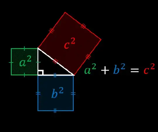

    Given how the image of the Pythagorean triangle with squares attached to its edges is seen as the quintessential symbol of the universality of mathematics, this first image of yours is pretty mind-blowing. I even once saw a suggestion of planting trees in the shape of a Pythagorean triangle to signal our intelligence to aliens. Maybe they'd just be like "WTF? LOL!" and scram ;) – Christian Feb 14 '14 at 22:55
  • 17
    I wish I could upvote this twice. It's perfect. – MJD Feb 15 '14 at 02:50
    @typ1232 I had difficulties in copying and rescaling a camel's shape with geogebra. But maybe the picture with pentagons is better in view of Christian comment. – Emanuele Paolini Feb 15 '14 at 07:45
    I had to ponder at this for a while, but when I got it, my mind exploded. Best proof of this theorem ever. – Felipe Jacob Feb 15 '14 at 16:27
    @tohecz: It is not difficult to prove it from Euclid's axioms, as evidenced by the fact that Euclid himself proves this! See this answer to another question, specifically this discussion by Alexander Giventhal. Mathematically, the claim (for any shape) is just equivalent to $a^2 + b^2 = c^2$. – ShreevatsaR Feb 15 '14 at 23:08
    I am feeling pretty embarrassed, but I don't get it: "Clearly the area of ABC is the sum of the areas of ACH and CBH, so the theorem is proven." Why does the sum equivalence prove the theorem? Where do the squares come in? – Daniel Feb 16 '14 at 17:11
  • @Daniel: if you have two similar figures, their area is proportional to the square of their size. Where "size" means the length of a reference segment (in this case the hypothenuse of the triangle). This is what we mean when we say that area is a $2$-dimensional measure, while length is $1$-dimensional. – Emanuele Paolini Feb 16 '14 at 17:43
    This is a very enlightening proof, but it does require that you understand that the areas of similar figures are indeed as the squares of some reference segment, which to me is not obvious at all (actually, I can't even think of a proof off the top of my head). – Jack M Feb 17 '14 at 00:09

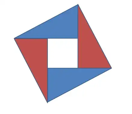

Bulberage's diagram is a common way to visualize it. I like this one too. Make four copies of your right triangle and arrange them like this: enter image description here
The total area of the square is $C^{2} $
The area of the white square is $(A-B)^{2} = A^{2}-2AB+B^{2}$. (Note that it doesn't matter if $A-B$ is negative because we're squaring it.)
The area of the four triangles is $2AB$.
The total area of the outer square is equal to the four triangles plus the inner square:
$C^{2} = A^{2} - 2AB + B^{2} + 2AB $
and we're done.

Surely no set of answers to this question is complete without mentioning Euclid's proof?
Diagram for Euclid's proof
In this figure, the right angle is at A, and AL is perpendicular to BC.
Euclid shows a little more than just the Pythagorean theorem; namely, that the two pink regions have equal areas, as do the two blue regions.
First, observe that triangle FBC can be rotated about B to become triangle ABD. This follows from side-angle-side (FB=AB, angle FBC = angle ABD, BC = BD). So these two triangles are congruent.
(Aside: That rotation is a perfect 90 degrees, so we have just shown in passing that segments CF and DA are (a) equal and (b) perpendicular. Strictly speaking, this diversion is unnecessary... But getting sidetracked is one of the joys of Euclidean geometry, in my opinion. I only wish had I learned this in school. End aside.)
Next, observe that both the pink square (FBAG) and the triangle FBC have base FB and height BA. So the pink square has twice the area of the triangle.
Next, observe that both the pink rectangle (BDLK) and the triangle ABD have base BD and height DL. So the pink rectangle also has twice the area of the triangle.
Since the triangles are equal, the pink square has the same area as the pink rectangle. A symmetric argument holds for the blue square and blue rectangle, which completes the proof.
Of course, as @studiosus points out, this does assume that the blue and pink rectangles add up to the square of BC...

Similar Triangle Approach
Here is the simplest proof I have seen that doesn't use areas. It just uses similar triangles. However, what is most intuitive is a subjective decision.
By similar triangles in the diagram below, we have $$ \large\frac{c_a}{a}=\frac ac\qquad\normalsize\text{and}\large\qquad\frac{c_b}{b}=\frac bc $$
$\hspace{3.5cm}$enter image description here
Thus, $$ \large c=c_a+c_b=a\frac ac+b\frac bc $$ Therefore, $$ \large c^2=a^2+b^2 $$

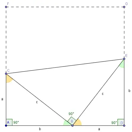

I like Garfield's proof the best. By the way, do you know that he became the president of the US five years after giving this proof! I like because it uses simple geometry and no rearrangement stuff, that others here have resorted to. Here it goes:
What I have done here is constructed a trapezium $ADCE$, such that $AD=a+b$, $AC = a$ and $DE = b$. Now we place a point $B$ on $AD$, such that $AB= b$ and $BD = a$. So, we can see by $SAS$ criteria, that triangles $ABC$ and $BDE$ are congruent.
This gives us $BC = BE = c$. Similarly we can show that, $\angle CBE = 180^{\circ} -(\angle ABC + \angle DBE) = 90^{\circ}$. Now we come to the crux of the proof, equating the area of the trapezoid and the individual triangles.
We know the area of the trapezoid, using the area formula of the trapezoid, is $\frac{(a+b)^2}{2}$. You can visualize it by extending the sides [as shown in the diagram], and observing that it becomes a square of side $a+b$, and seeing that the two trapezoids formed are congruent. Now:
$$\begin{align} (ACDE) & = (ABC) + (BCE) + (BDE) \\ \frac{(a+b)^2}{2} & = \frac{1}{2}ab + \frac{1}{2}ab + \frac{1}{2}c^2 \\ (a+b)^2 & = ab + ab +c^2 \\ a^2+b^2+2ab & = 2ab + c^2 \\ a^2+b^2 & = c^2 \end{align}$$

The accepted answer provides no explanation for the diagrams: enter image description here
Each diagram shows an outer square, $\color{red}{(a+b)}$ units on a side, divided into other figures. The diagrams suggest different expressions for the area of the outer square. Equating these expressions leads to the equation $a^2+b^2=c^2$.
Total area of $\color{red}{outer}$ square = Area not covered by triangles + Area covered by triangles
$\color{red}{(a+b)^2} = c^2 + 4(\dfrac1{2}ab)$ ________$\color{red}{(a+b)^2} = a^2 +b^2 + 4(\dfrac1{2}ab)$
$c^2 + 4(\dfrac1{2}ab)= a^2 +b^2 + 4(\dfrac1{2}ab)$
$\therefore c^2 = a^2+b^2$
source: Algebra Structure and Method Book $1$ by Brown, Dolciani et al.
