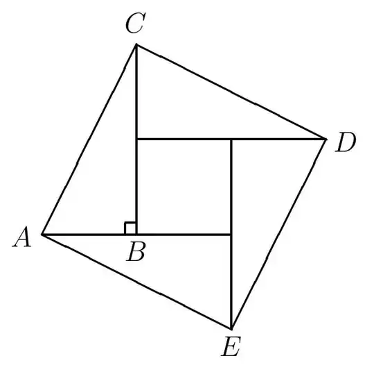

Area can be defined using calculus. Suppose you have a square in $\mathbb{R}^2$. enter image description here Let $x$ be the change in the first coordinate going from E to D. Let $y$ be the change in the second coordinate going from E to D. We can see that the area of the square is $(x - y)^2 + 2xy = x^2 - 2xy + y^2 + 2xy = x^2 + y^2$. With no assumptions about what properties the distance formula follows, that just proves that the area is $x^2 + y^2$ and proves nothing about what the distance formula is. We could seek a function $d$ that's a binary function from $\mathbb{R}^2$ to $\mathbb{R}$, in other words, a function from $(\mathbb{R}^2)^2$ to $\mathbb{R}$ satisfying certain properties where we say that $\forall x \in \mathbb{R}\forall y \in \mathbb{R}\forall z \in \mathbb{R}\forall w \in \mathbb{R}d((x, y), (z, w))$ is the distance from $(x, y)$ to $(z, w)$. We seek a function $d$ satisfying the following properties:

It can be easily shown that $d((x, y), (z, w)) = \sqrt{(z - x)^2 + (w - y)^2}$ is the unique function satisfying those properties. That just shows that using this definition of distance, the Pythagorean theorem holds for all right angle triangles whose legs are parallel to the axes. To show that the Pythagorean theorem holds for all right angle triangles, we also have to show that that function satisfies the following property
