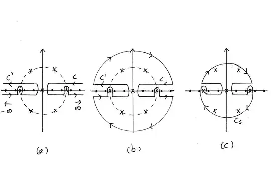

The sum can be evaluated by employing the fact that the function
\begin{align*} \dfrac{1}{\tan \pi z} \end{align*}
has simple poles at all integers $n$. This allows us to write
\begin{align*} \sum_{n=1}^\infty \frac{1}{n^6 - x^6} = \frac{1}{2 i} \oint_C \dfrac{1}{(z^6 - x^6) \tan \pi z} dz \end{align*}
where the contour $C$ is defined in fig (a). The dots are poles at non-zero integer values of $z$, whereas the crosses mark the location of the other poles of $\dfrac{1}{(z^6 - x^6) \tan \pi z}$.
We have
\begin{align*} \sum_{n=1}^\infty \frac{1}{n^6 - x^6} & = \frac{1}{2} \sum_{n=1}^\infty \frac{1}{n^6 - x^6} + \frac{1}{2} \sum_{n=-1}^{-\infty} \frac{1}{n^6 - x^6} = \frac{1}{4 i} \oint_{C+C'} \dfrac{1}{(z^6 - x^6) \tan \pi z} dz \end{align*}
where the contour $C'$ is defined in fig (a). We complete the path of integration along semicircles at infinity (see fig (b)) since the integration along them vanishes. Since the resulting enclosed area contains a finite number of singularities marked by crosses, we can shrink this contour down to a contour, $C_s$, surrounding these finite number of poles (see fig (c)). So that
\begin{align*} \frac{d}{dx} \ln f(x) = \frac{3}{x} -6 x^5 \frac{1}{4i} \oint_{C_s} \frac{dz}{(z^6-x^6) \tan \pi z} \qquad (*) \end{align*}
