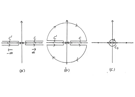

where the contour $C$ is defined in fig (a). The dots are poles at odd integer values of $z$, whereas the crosses mark the location of the other poles of $\dfrac{\tan \dfrac{\pi z}{2}}{(4z^2+1-2x)}$. Since we will be putting $x=1$ at the end of the calculation and we want to avoid the poles $z = \pm \sqrt{2x-1}/2$ coinciding with odd integer values, we will restrict ourselves to $x < 5/2$. For $0 \leq x < 1/2$ the poles take imaginary values: $\pm i \sqrt{1-2x}$.

\begin{align*} \sum_{n=1}^\infty (-1)^n \frac{2 \sin^2 \dfrac{\pi n}{2}}{4 n^2 + 1 - 2x} & = \frac{1}{2} \sum_{n=1}^\infty (-1)^n \frac{2 \sin^2 \dfrac{\pi n}{2}}{4 n^2 + 1 - 2x} + \frac{1}{2} \sum_{n=-1}^{-\infty} (-1)^n \frac{2 \sin^2 \dfrac{\pi n}{2}}{4 n^2 + 1 - 2x} \\ & = \frac{1}{4 i} \oint_{C+C'} \dfrac{\tan \dfrac{\pi z}{2}}{(4z^2+1-2x)} dz \end{align*}
where the contour $C'$ is defined in fig (a). We complete the path of integration along semicircles at infinity (see fig (b)) since the integration along them vanishes. Since the resulting enclosed area contains a finite number of singularities marked by crosses, we can shrink this contour down to a contour, $C_s$, surrounding these finite number of poles (see fig (c)). So that
\begin{align*} \frac{d}{dx} \ln f(x) = \frac{1}{4 i} \oint_{C_s} \dfrac{\tan \dfrac{\pi z}{2}}{(4z^2+1-2x)} dz \end{align*}
