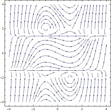

A direction field plot shows (look at $y = \pm~ \sqrt{2}$):

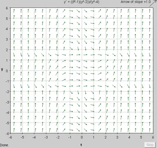

Additionally, if we look at $t = \pm 1$, on the following direction field plot, we can see the horizontal tangents as:
Amzoti
  • 56,629
    It should also be mentioned that all the "flow curves" have horizontal tangents at "times" $ \ t \ = \ \pm 1 \ $ ; this is the contribution of the $ \ t^2 - 1 \ $ factor in the differential equation. – colormegone Jan 17 '14 at 04:36
