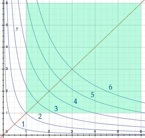

A three-dimensional lattice would be preferable for investigating this, but we can get by with a two-dimensional grid. Since we wish to count the ordered triples for which $ \ b^2 \ < \ 4ac \ $ , we can set up a lattice for $ \ a \ $ and $ \ c \ $ running from 1 to 6 (contained in the light green square), and plot level curves for $ \ \frac{1}{4}b^2 \ $ with $ \ b \ $ also running from 1 to 6 . At each integer value of $ \ b \ $ , we can now easily count the number of lattice points "below" or on each level curve to find the number of combinations which do produce a discriminant value $ \ b^2 - 4ac \ \ge \ 0 \ $ . (The red diagonal line is added to indicate the symmetry in the choices for for $ \ a \ $ and $ \ c \ $ , which can simplify the counting.) These are then to be discarded from the count of desired outcomes.
We find that the number of combinations for each value of $ \ b \ $ is
b = 1 : 36
b = 2 : 36 - 1 = 35
b = 3 : 36 - 3 = 33
b = 4 : 36 - 8 = 28
b = 5 : 36 - 14 = 22
b = 6 : 36 - 17 = 19
As found by the other solvers here, the total number of combinations leading to complex-valued zeroes is 173 , making the probability $ \ \frac{173}{216} \ . $
