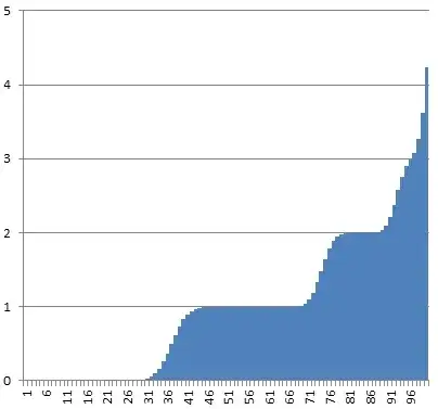

The graph of the formula in question looks pretty interesting. X-axis is $i$, Y-axis is expected value of $i$th bin, for $k=100$ and $n=100$. I generated it by averaging 10,000 random placements.
