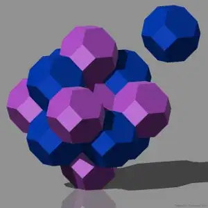

I'm most interested in the tessellation of regular polygons and their 3D counterparts. I've noticed that simple shapes like squares or cubes can be tessellated but not circles or spheres.
tesselation example
Somewhere after hexagons, shapes lose that ability to be tessellated by only themselves. Although it is intuitively clear to me when shape can be tessellated, I cant put it into words. Please describe to me, in a fair amount of detail, what the lesser sided shapes had that the greater sided shapes did not inorder to be tessellated.

Edit 2 : Let us consider $3D$ version. Fedorov found that there are exactly five 3-dimensional parallelohedra. You can see beautiful figures here. You'll be interested in these figures.

    I appreciate your effort. Yes, in the 3D as well please. Just enough detail for any person's curiosity with uni-polygonal tessellation to be satisfied. Also, I'd be pleased if someone put a diagram into Zubin Mukerjee's answer. – Nick Dec 28 '13 at 17:34
  • Have you seen my edit? This page has an interesting version. And the question is related with billiards! Later, I'll add some explanation. – mathlove Dec 28 '13 at 17:41
  • very interesting – Nick Dec 28 '13 at 17:44
    @Nick: I added a bit with beautiful figures. I love them. – mathlove Dec 29 '13 at 02:01
