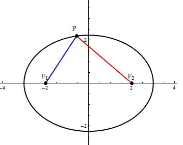

For what it's worth, here's another proof without calculus.
Fix a perimeter $p$, and suppose that $a$, $b$, and $c=p-a-b$ are the side lengths of a largest triangle with perimeter $p$. Let $F_1$, $F_2$, and $P$, respectively, be the vertices of the triangle opposite the sides of length $a$, $b$, and $c$.
Given $c$, we'll show that it must be the case that $a=b$, proving that the largest triangle is isosceles. Repeating the argument given $a$ or $b$ will prove it must be equilateral.
Place $F_1$ and $F_2$ on the $x$-axis, and consider where $P$ can lie. Wherever it is, the sum of the distances from $P$ to the two points $F_1$ and $F_2$ is $a+b$, which is constant, so the locus of possible locations of $P$ is an ellipse with foci $F_1$ and $F_2$. The area of $F_1F_2C$ is $c|y|$, where $y$ is the $y$-coordinate of $P$, so the triangle's area is greatest when $P$ is at a point on the ellipse as far from the $x$-axis as possible. Therefore $P$ is at an endpoint of the ellipse's vertical axis, and by symmetry, $a=b$.
Here's a picture with $P$ not at the optimal position.
Steve Kass
