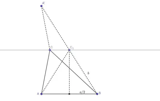

First, let us show that it has to be isosceles triangle. Suppose the opposite, that the triangle $ABC$ is optimal. Draw line through point $C$ parallel with $AB$ and find the mirror point $A'$ of $A$ with respect to that line. Line $BA'$ meets the parallel line at point $C_1$.
Obviously, triangles $ABC$ and $ABC_1$ have the same area but triangle $AMC_1$ has smaller perimeter because:
$$AC_1+BC_1=A'C_1+C_1B<BC+CA'=BC+AC$$
So triangle $ABC$ is not optimal and we should consider only triangles that are isosceles.

Oldboy
  • 17,264
    +1 for the diagram! But after proving that the triangle has to be isosceles (i.e. $AC$ has to be equal to $BC$), you are done, because an identical argument using $BC$ as the base shows that $AC$ has to be equal to $AB$. – TonyK Dec 21 '18 at 13:36
  • "Suppose the opposite, that the triangle ABC is optimal." -- you should first show the problem is compact before picking an optimal ABC. – user10354138 Dec 21 '18 at 14:24
  • @TonyK You are right, I have missed the most elegant solution: "Suppose that the optimal triangle ABC has a pair of sides of different lengths... Than comes the part with the diagram... And yes, we are done. Thanks! – Oldboy Dec 21 '18 at 14:54
