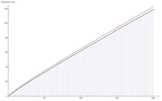

I was interested to see the accuracy of the upper bound proposed by Henry's neat solution. The following diagram illustrates:
  • Red curve: Henry's upper bound of $\frac{n}{2}+ \sqrt{\frac{n}{2} \log_e n}$
  • The blue dots: the actual exact expectation of the sample maximum, as $n$ increases from 1 to 200.
To my surprise, the upper bound appears to get worse (in an absolute sense) as $n$ gets larger ... not better.

  • 5,244
    My earlier numbers suggest that by the time you get to $n=10^6$, the gap is almost $200$, which is obviously larger in absolute terms than for small $n$, but a smaller proportionate error – Henry Dec 04 '13 at 10:17
