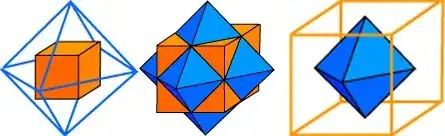

  • The tetrahedron is self-dual (i.e. its dual is another tetrahedron).
  • The cube and the octahedron form a dual pair.
Therefore let's construct first the dual of an arbitrary octahedron, which is not quite an arbitrary hexahedron: $$ h_1 = (s_1 + s_3 + s_5)/3 \quad ; \quad h_2 = (s_2 + s_3 + s_5)/3 \quad ; \quad h_3 = (s_1 + s_4 + s_5)/3 \quad ; \quad h_4 = (s_2 + s_4 + s_5)/3 \quad ; \quad h_5 = (s_1 + s_3 + s_6)/3 \quad ; \quad h_6 = (s_2 + s_3 + s_6)/3 \quad ; \quad h_7 = (s_1 + s_4 + s_6)/3 \quad ; \quad h_8 = (s_2 + s_4 + s_6)/3 $$ Substitute this into the abovementioned formula for $h(\xi,\eta,\zeta)$ and then simplify. The outcome (with a little help from Maple) is, to my great surprise: $$ \frac{1}{6}\left[\, (s_1 + s_2 + s_3 + s_4 + s_5 + s_6) + (s_2 - s_1)\,\xi + (s_4 - s_3)\,\eta + (s_6 - s_5)\,\zeta\, \right] $$ The interpolation with the dual hexahedron of an arbitrary octahedron is linear. Because of the ispoarametrics ( substitute $h=x,y,z$ ), it also means that the coordinates of the dual are far from arbitrary - but we did already know that, didn't we?
The other way around, we construct the dual of an arbitrary hexahedron, which is (not quite) an arbitrary octahedron: $$ s_1 = (h_1 + h_3 + h_5 + h_7)/4 \quad ; \quad s_2 = (h_2 + h_4 + h_6 + h_8)/4 \\ s_3 = (h_1 + h_2 + h_5 + h_6)/4 \quad ; \quad s_4 = (h_3 + h_4 + h_7 + h_8)/4 \\ s_5 = (h_1 + h_2 + h_3 + h_4)/4 \quad ; \quad s_6 = (h_5 + h_6 + h_7 + h_8)/4 \\ s_0 = (s_1 + s_2 + s_3 + s_4 + s_5 + s_6)/6 $$ Substitute this into the abovementioned expression for $s(\xi,\eta,\zeta)$ and simplify. The outcome (with a little help from Maple) is, again to my surprise: $$ \frac{1}{8}\left[ \,( h_1+h_2+h_3+h_4+h_5+h_6+h_7+h_8) \\ + (-h_1+h_2-h_3+h_4-h_5+h_6-h_7+h_8)\xi \\ + (-h_1-h_2+h_3+h_4-h_5-h_6+h_7+h_8)\eta \\ + (-h_1-h_2-h_3-h_4+h_5+h_6+h_7+h_8)\zeta \,\right] $$ The interpolation with the dual octahedron of an arbitrary hexahedron is linear again.

In all dimensions higher than four, there are only three convex regular polytopes: the simplex, the hypercube, and the cross-polytope. In three dimensions, these coincide with the tetrahedron, the cube, and the octahedron. Where the (self-dual, linear) simplex may be considered as a trivial case.
Question. In all dimensions higher than three, does the isoparametric transformation give a linear interpolation for an arbitrary function discretized at the dual polytope of a "finite element" with the hypercube or the cross-polytope as a parent?
