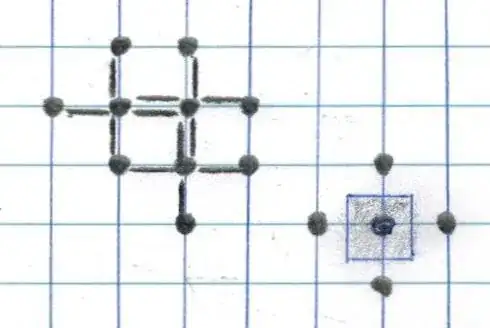

UPDATE. A picture says more than a thousand words:
It is seen that the five node stars in the grid have double chemical bonds, so to speak. This is the way all data points are actually available. However, there is some ambiguity involved in assigning the function values - already present in 1D. Which can be resolved by assigning a certain domain - shaded region around the central node $(0)$ - to each of the five node stars.
Han de Bruijn

  • You are not using all datapoints which are available. I think it would be good to mention this. Furthermore, correct me if I am wrong, but basically you are fitting a 1D parabola for each direction independently. It is very simple (which is good, because that was the question), but I think you wrote it down in a rather complicated manner. Could you write it in a simpler (shorter) way? – EdG Nov 14 '17 at 14:07
  • @EdG: Sorry to inform you that I am using all data points. And I am fitting a 2D parabola for all directions. The shorter/simpler way of writing it down is found in the section below Linear isoparametrics with dual finite elements. I did it the way it has been done above that link because I want to spread a general message about geometrical shapes and interpolations. But anyway, I shall update the answer to clarify your first point. Be patient. – Han de Bruijn Nov 14 '17 at 17:38
  • @EdG: You're welcome to take notice of my update. – Han de Bruijn Nov 14 '17 at 20:05
  • Thanks for the update. You say you are using all data points. Aren't you referring to all datapoints that lie on a certain axis? For example, the datapoint $(1, 1, 1)$ is not used. Although it is not entirely clear for me, but I think in this problem, as there are $3^d$ datapoints, you are not using all datapoints which are available. Also, a 2D parabola, I don't see it, because you ignore terms $xy$, $xz$ and $yz$. Your partial derivatives gives the same formula's for 1D parabolic interpolation, so I don't see the why it is 2D. – EdG Nov 14 '17 at 23:21
