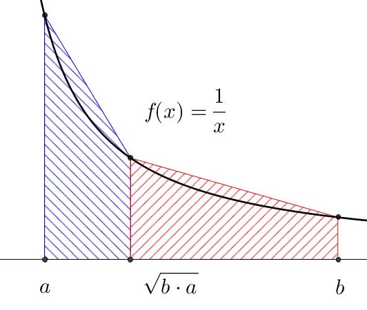

The inequality can be written as $\int_y^x \frac{1}{t}dt < \frac{x-y}{\sqrt{xy}}$. I wonder if one can prove it by comparing areas, and the shape of $\frac{1}{x}$. – N. S. Nov 22 '13 at 15:46

1@N.S. This demonstration on WA site seems to be based on geometric idea. It was the first search result when I googled for logarithmic geometric mean inequality. – Martin Sleziak Nov 22 '13 at 16:22
Very nice, that does it! – N3buchadnezzar Nov 22 '13 at 16:36

Since $1/x$ is concave for $x>0$ then \begin{align*} \log b - \log a = \int_b^a\frac{\mathrm{d}x}{x} < \underbrace{ \frac{1}{2} \frac{b - a}{\sqrt{ba}} }_\text{Blue Area} +\underbrace{ \frac{1}{2}\frac{b - a}{\sqrt{ba}} }_{\text{Red area}} = \frac{b - a}{\sqrt{ba}}\end{align*} Implying $$ \hspace{4cm}\sqrt{ab} < \cfrac{b - a}{\log b - \log a} \hspace{4cm} \blacksquare$$
