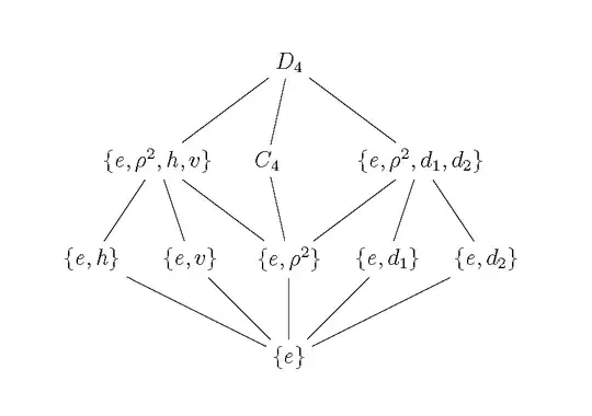

There are therefore $10$ subgroups with inclusions given by the following Hasse diagram.
Define $C(n,b,G)$ to be the set of configurations of the $n\times n$ grid with $b$ marked squares that are invariant under the group $G.$ We are ultimately interested in $b=n,$ but will start out with slightly greater generality. Define $\overline{C}(n,b,G)$ to be the subset of $C(n,b,G)$ consisting of elements that are not invariant under any group that properly contains $G.$ The number we wish to compute, which we denote $K(n),$ is $$ \begin{aligned} (*)\quad K(n)=&\frac{\lvert\overline{C}(n,n,D_4)\rvert}{1}+\frac{\lvert\overline{C}(n,n,\{e,\rho^2,h,v\})\rvert}{2}+\frac{\lvert\overline{C}(n,n,C_4)\rvert}{2}+\frac{\lvert\overline{C}(n,n,\{e,\rho^2,d_1,d_2\})\rvert}{2}\\ &+\frac{\lvert\overline{C}(n,n,\{e,h\})\rvert}{4}+\frac{\lvert\overline{C}(n,n,\{e,v\})\rvert}{4}+\frac{\lvert\overline{C}(n,n,\{e,\rho^2\})\rvert}{4}+\frac{\lvert\overline{C}(n,n,\{e,d_1\})\rvert}{4}\\ &+\frac{\lvert\overline{C}(n,n,\{e,d_2\})\rvert}{4}+\frac{\lvert\overline{C}(n,n,\{e\})\rvert}{8}. \end{aligned} $$
(Added: The set $C(n,n,G)$ is the set of colorings whose stabilizer contains $G,$ while $\overline{C}(n,n,G)$ is the set of colorings whose stabilizer equals $G.$ The formula (*) for $K(n),$ the number of orbits, comes from counting each coloring with a weight equal to the reciprocal of the size of its orbit, the weight having been computed using the orbit-stabilizer theorem. (See the end of the post.) For example, if $x$ has stabilizer $D_4,$ then the weight is $1/1=8/8;$ if $x$ has stabilizer $\{e,\rho^2,h,v\},$ then the weight is $1/2=4/8.$ Of course, as noted above, the use of (*) and the inclusion-exclusion argument below is rendered superfluous by the use of the orbit counting theorem. It is interesting that although (*) involves all ten subgroups of $D_4,$ the final expression (**) involves only the seven cyclic subgroups. My naive derivation does not explain this, but the orbit counting theorem makes it manifest that that must be the case.)
From the diagram, we obtain expressions for the $\overline{C}(n,b,G)$ in terms of the $C(n,b,G):$ $$ \begin{aligned} \lvert\overline{C}(n,b,D_4)\rvert&=\lvert C(n,b,D_4)\rvert\\ \vert\overline{C}(n,b,\{e,\rho^2,h,v\})\rvert&=\lvert C(n,b,\{e,\rho^2,h,v\})\rvert- \lvert C(n,b,D_4)\rvert\\ \vert\overline{C}(n,b,C_4)\rvert&=\lvert C(n,b,C_4)\rvert- \lvert C(n,b,D_4)\rvert\\ \vert\overline{C}(n,b,\{e,\rho^2,d_1,d_2\})\rvert&=\lvert C(n,b,\{e,\rho^2,d_1,d_2\})\rvert- \lvert C(n,b,D_4)\rvert\\ \vert\overline{C}(n,b,\{e,h\})\rvert&=\lvert C(n,b,\{e,h\})\rvert- \lvert C(n,b,\{e,\rho^2,h,v\})\rvert\\ \vert\overline{C}(n,b,\{e,v\})\rvert&=\lvert C(n,b,\{e,v\})\rvert- \lvert C(n,b,\{e,\rho^2,h,v\})\rvert\\ \vert\overline{C}(n,b,\{e,d_1\})\rvert&=\lvert C(n,b,\{e,d_1\})\rvert- \lvert C(n,b,\{e,\rho^2,d_1,d_2\})\rvert\\ \vert\overline{C}(n,b,\{e,d_2\})\rvert&=\lvert C(n,b,\{e,d_2\})\rvert- \lvert C(n,b,\{e,\rho^2,d_1,d_2\})\rvert\\ \vert\overline{C}(n,b,\{e,\rho^2\})\rvert&=\lvert C(n,b,\{e,\rho^2\})\rvert- \lvert \overline{C}(n,b,\{e,\rho^2,h,v\})\rvert- \lvert \overline{C}(n,b,C_4)\rvert\\ &\quad- \lvert \overline{C}(n,b,\{e,\rho^2,d_1,d_2\})\rvert- \lvert \overline{C}(n,b,D_4)\rvert\\ &=\lvert C(n,b,\{e,\rho^2\})\rvert- \lvert C(n,b,\{e,\rho^2,h,v\})\rvert- \lvert C(n,b,C_4)\rvert\\ &\quad- \lvert C(n,b,\{e,\rho^2,d_1,d_2\})\rvert+2 \lvert C(n,b,D_4)\rvert\\ \vert\overline{C}(n,b,\{e\})\rvert&=\lvert C(n,b,\{e\})\rvert- \lvert \overline{C}(n,b,\{e,h\})\rvert- \lvert \overline{C}(n,b,\{e,v\})\rvert- \lvert \overline{C}(n,b,\{e,\rho^2\})\rvert\\ &\quad- \lvert \overline{C}(n,b,\{e,d_1\})\rvert- \lvert \overline{C}(n,b,\{e,d_2\})\rvert- \lvert \overline{C}(n,b,\{e,\rho^2,h,v\})\rvert\\ &\quad- \lvert \overline{C}(n,b,C_4)\rvert- \lvert \overline{C}(n,b,\{e,\rho^2,d_1,d_2\})\rvert- \lvert \overline{C}(n,b,D_4)\rvert\\ &=\lvert C(n,b,\{e\})\rvert- \lvert C(n,b,\{e,h\})\rvert- \lvert C(n,b,\{e,v\})\rvert- \lvert C(n,b,\{e,\rho^2\})\rvert\\ &\quad- \lvert C(n,b,\{e,d_1\})\rvert- \lvert C(n,b,\{e,d_2\})\rvert+2\lvert C(n,b,\{e,\rho^2,h,v\})\rvert\\ &\quad+2\lvert C(n,b,\{e,\rho^2,d_1,d_2\})\rvert \end{aligned} $$ These imply that $$ \begin{aligned} (**)\quad K(n)=&\frac{\lvert C(n,n,C_4)\rvert}{4}+\frac{\lvert C(n,n,\{e,h\})\rvert}{8}+\frac{\lvert C(n,n,\{e,v\})\rvert}{8}+\frac{\lvert C(n,n,\{e,\rho^2\})\rvert}{8}\\ &+\frac{\lvert C(n,n,\{e,d_1\})\rvert}{8}+\frac{\lvert C(n,n,\{e,d_2\})\rvert}{8}+\frac{\lvert C(n,n,\{e\})\rvert}{8}. \end{aligned} $$
